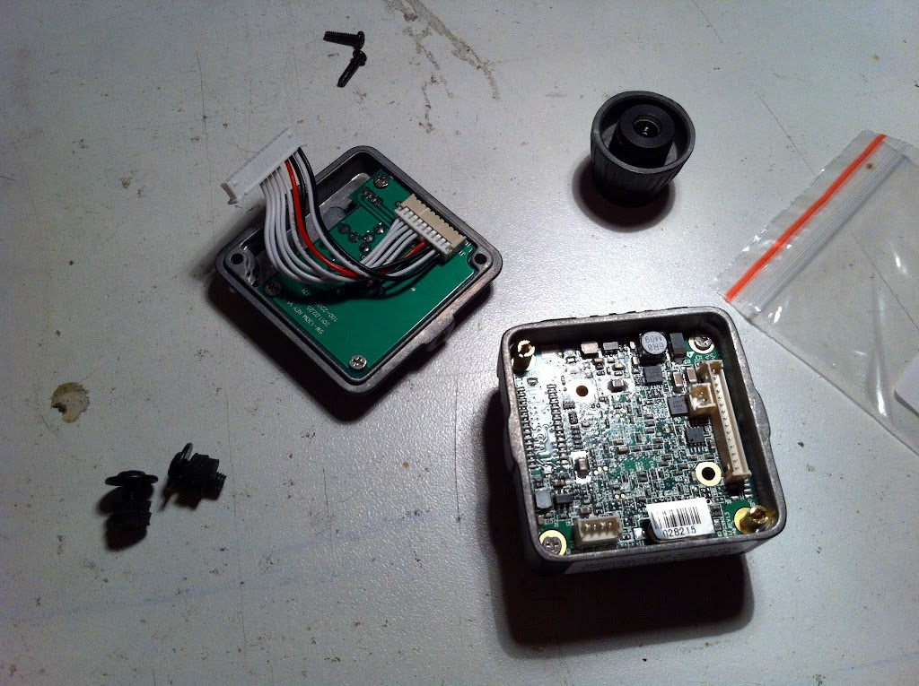

#91
Mein video mitt IR filter
http://www.youtube.com/watch?v=cPwvJTUDGh0
schreibe mitt [email protected] fur ein IR filter
Dann folge :
Opend the cam
And now what ????
Looks like the same filter

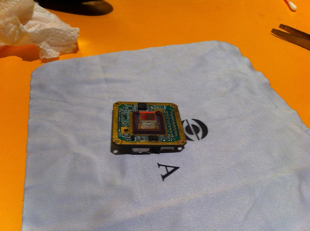

The chip is under a glass plate
You can not damage it

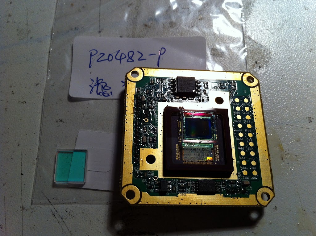

Use a litlle force to get the old filter off
We tested the old filter also.
Some IR light came trough this filter
Also this filter is not glued but taped
But it is a very sticky 3M substance
clean the sensor glass with alcahol and a microfiber cloth
Check it mirroring in the light if it is clean.
Now use the tape and remove the inside of the tape
Be very carefull to do this straight.
My first tape failed and i had to clean the sensor again.
Lucky we had 2 tapes
Clean 1 side of the filter with alcahol and microfiber cloth
Undo the paper of the 3M tape
Now you have to be very relax to put the filter on
Use some pressure on the filter with the microfiber cloth
And use a little alcahol to clean it.
Yeah
My Cam still works
I hope for the better.
Goodluck
